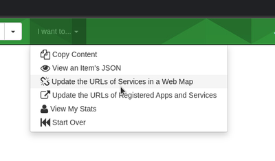

There is! The AGO Assistant is what you want. In the top menu bar, click on "I want to...", then select "Update the URLs of Services in a Web Map".
Then just find your web map and update the URL to point to the view layer.

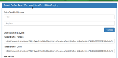

Hi,  This doesn't seem to work for me.  Can I check, when you press 'replace' does something pop up that you have to click to confirm?  I suspect that I am not able to process this because popups are being prevented by my organisation.  Thanks

I don't think so. But no matter, you can do this same thing more directly using the other option to view/edit the JSON.

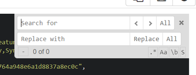

One of the items in the operationalLayers list will be your layer, and the url is the property you need to update. You can even use ctrl+f and get a find-and-replace dialog in the JSON editor as well!
Some people prefer the other method because you can't accidentally break your map by misplacing a comma or something. But as long as you're careful, you should be all right. If I have larger edits to make, I will often copy the JSON to a text editor and make my changes there, so that I have the undo option if something doesn't work.
