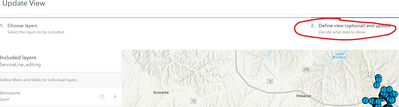

When "updating view" from the settings page of the view layer.
I was just selecting the layer and then selecting Next --> Update
I can't recall if I found this link in another community post or google search, but it lead me to my solution.
https://support.esri.com/en-us/knowledge-base/problem-hosted-feature-view-does-not-inherit-new-field...

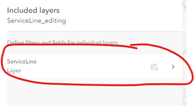

After selecting the layer, select define view.
Expand the layer.
Expand the fields
Select your missing field, then update. My other views showed the new field so I figured something was just not working.
