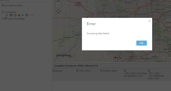

I get this error when clicking the attribute table of a hosted feature layer in AGOL.

I tried these solutions from this help doc even though it references ArcMap and not Pro. No success. And there are a couple similar threads to my problem in GeoNet, but they didn't help.
https://support.esri.com/en/technical-article/000016280
The things I did were:
1. remove the special character (i.e. &) I had in one field
2. create a new webmap and added the Complaints feature layer
3. deleted the original 5 features
4. added two new features
5. Where there was <Null> in a field I added a value even though this wasn't a problem before.
6. found you do not get the error when viewing the table of a hosted feature layer view
7. found you can see the features in the My Content of the Feature layer
8. you can also see the features in a Dashboard and in Pro
So, basically I can see the features in the table everywhere besides in the feature layer itself when viewing from the Map Viewer.
