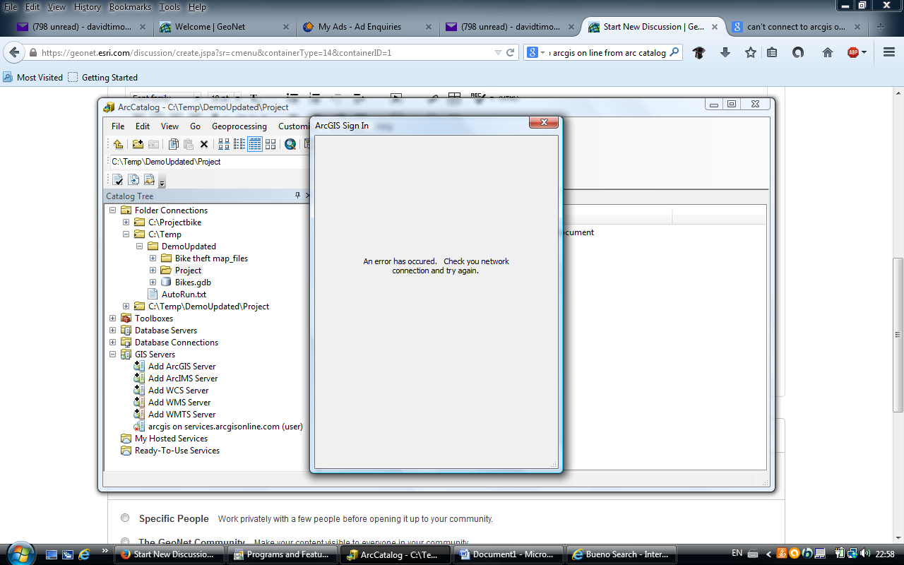

Hi, I cannot connect to ArcGIS Online via ArcCatalog. I get an error message saying `An error has occurred. Check your network connection and try again.` Has anyone come across this problem before and does anyone have a solution?

I'm getting the same error message, in ArcMap 10.3 though. For the sake of people trying to search for the error message, the actual error message, including misspellings, is:
ArcGIS Sign In
An error has occured.   Check you network connection and try again.
