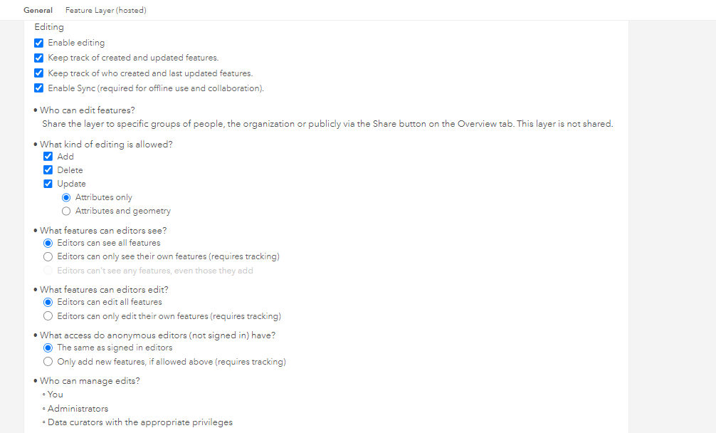

Editing options all enabled under Settings tab

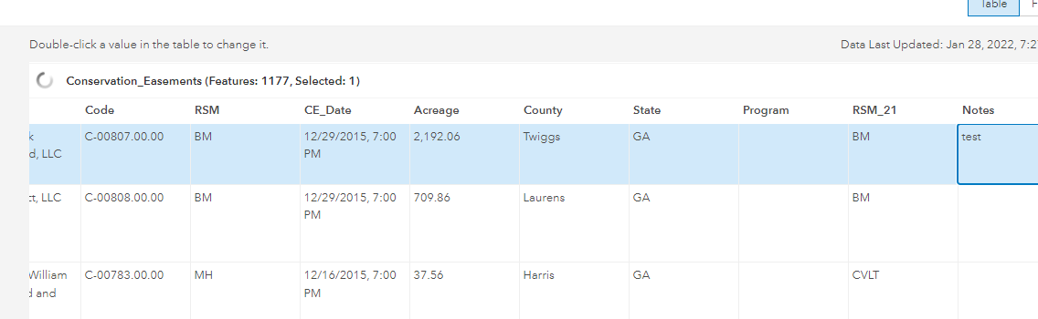

Screen when I try to edit in the feature layer data tab. The loading circle will continue for a minute or two and then go away and the edit will disappear.

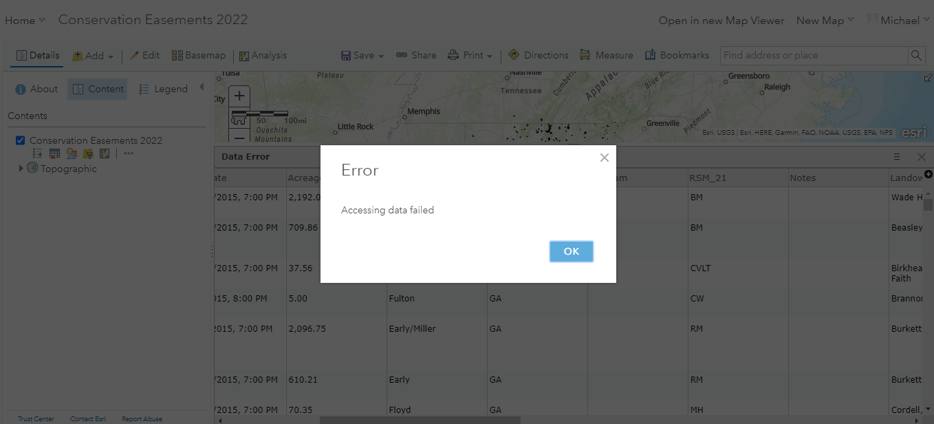

Pop up when I try to edit attributes in Map Viewer Classic Attribute Table
