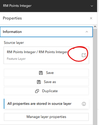

Is there a reason you're putting the info in an Excel sheet rather than just adding the fields to the copy of the data? If not, open the layer's item detail page:

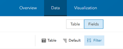

Then go to 'Data' and click 'Fields.'

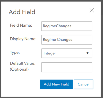

Click 'Add' and set up your field. Repeat for the other field.
Back in the table view, double click the cells to add your values. Return to your map and you should be good to go.

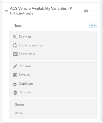

Are you sure you're working on your own copy of the data? If you are using the Living Atlas version (or anybody else's that you don't have edit privileges for), you can't edit that. You'll need to save a copy in your own AGO account by clicking the layer's 3 dots and Save As. Then, you'll make your edits on that version.
Student00
Dang so I am using a copy I made of the layer but theres no add button.
