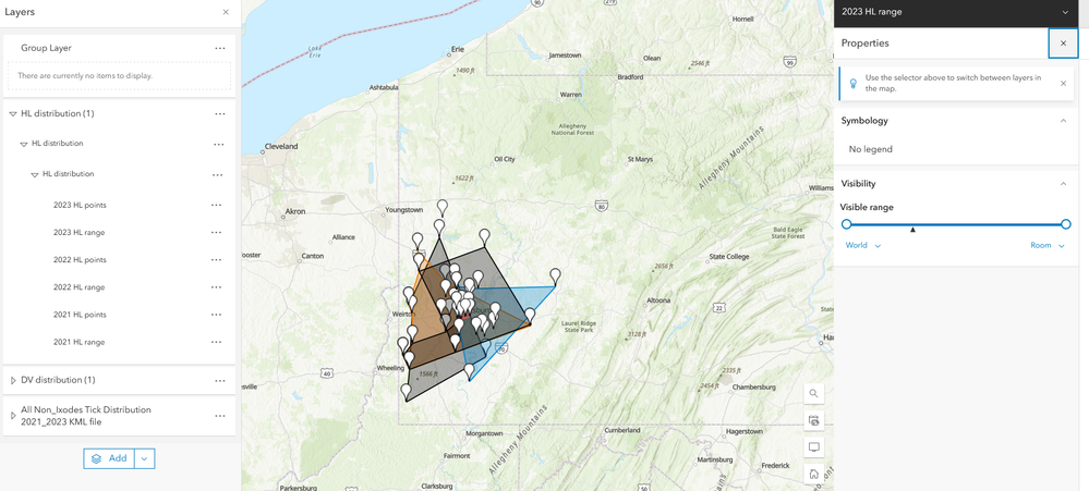

I am using the free version of ArcGIS Online public account through the web browser. I cannot seem to add or edit legends on my maps. Is this something I should be able to do, or is this feature restricted to paid plans?
I have a data set that consists of a lot of GPS coordinates.  I am trying to group them together and edit the formatting for each group at once, like I know you can do in Google MyMaps with layers.  I then want to add a figure legend to show what each color/symbol group means.  This seems like a basic functionality, but I am having a hard time figuring out how to do it.  I seem unable to edit the figure legend.  I try to follow walk-throughs but the options are just not there for me.  Is this something you can do on a free account, or would you need to purchase a plan to do something like this?  Or am I just missing something?  Thanks in advance.

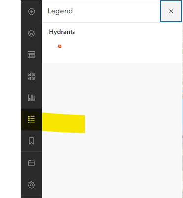

Hi @JayGoetz
In Map Viewer the legend is automatically generated for you. Click the legend button on the dark toolbar on the left. The legend displays based on the way you have symbolized the layers in your map.
