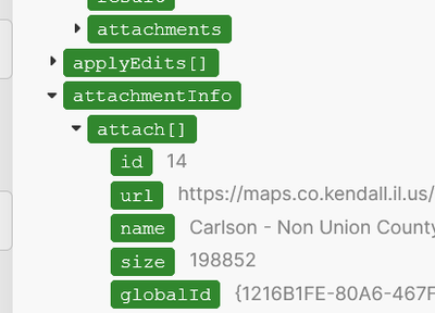

In Make, you should be able to pull the attachment ID directly:
Together with the objectid of the feature, you can have Make cobble together the full URL of the attachment and then supply that string to an attribute edit using the "Make HTTP Request" command.

This seems like the solution I need, but I can't find attachmentInfo in the list on Make. Searching the list for "attachmentid" turns up nothing. Did I miss a step somewhere?
Here are all the items that come up when I try to add an item to the File URL box:
Also, the URL for my attachments includes a token at the end. Will that be an issue?
