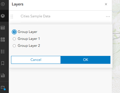

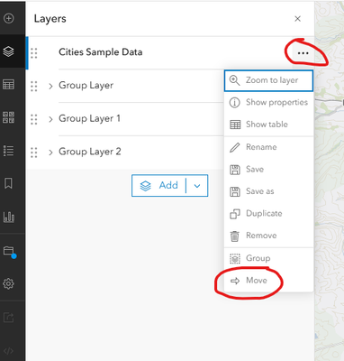

I think this is intended functionality to allow you to drop a layer within a group.  I can see your point though if you have several groups expand as you try to move a layer.  As an alternative, you could use the Move button in the layers options. This will bring up a list of Groups in the web map so that you can select the appropriate group from this list that the layer will be moved to:

Thanks. I appreciate the feedback! Good to know about the Move functionality; unfortunately, not all layers/group layers I'm rearranging are going into another group. It seems like a hefty workaround for an obstacle that doesn't have to exist (not your fault).
I'd rather deal with the two extra clicks of adding a layer to a sublayer in a group.
