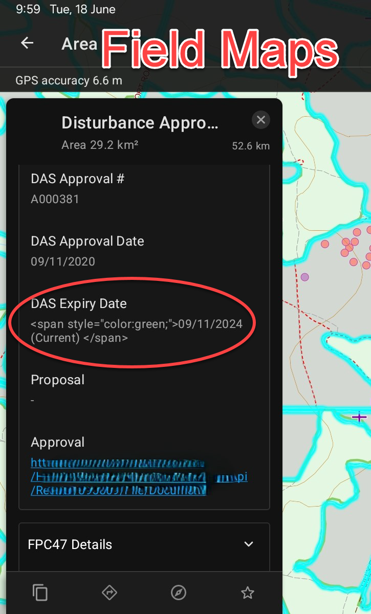

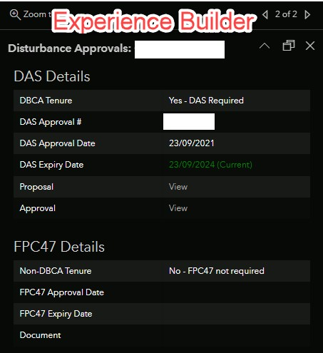

I've written an arcade script which pulls dates from a table using a lookup for a selected feature in the map. The popup returns the results as a list of Fields, with some text green or red depending on if the data has "expired" (date in the past or future).
You can see the text formatting on lines 28-32. What I want to know is do I need to change something or do it differently to get this working in Field Maps? Currently it works great in an Experience Builder WebApp, but not Field Maps (screenshots below).

Might have to return text instead?  Not sure how that looks in Experience Builder though. (Edit - Seems to work there, as well.)  Unfortunately, there are a lot of different contexts that show a lot of different things differently.  (Apologies for how vague that part is.)  I've found that you will see differences in pop-ups in Web Map Viewer, Field Maps, and elsewhere - and how you return or display those pop-ups will also yield differences.  (As in, you can add a text pop-up, and you add an expression to it you calculated, and that might show different results than adding an Arcade pop-up with the same expression - and also info elements in Field Maps may display differently - where you can also calculate an expression elsewhere and bring that into the info element.)
I am assuming you should be able to get your data similar to how you are above, but then build out your HTML when returning it as text.  I believe when you return text in a pop-up that is HTML formatted it should appear as HTML in most places, but not all places - I wouldn't ever guarantee the same behavior everywhere.

Edit - If you add an Arcade pop-up in Web Map Viewer - you will end up with the return value I posted above.  I checked that the pop-up formats HTML in Field Maps and in Experience Builder - but oddly enough, it will not format it in the pop-up in Web Map Viewer itself. Might be a way to discern the context and return different types/values, but for Field Maps and Experience Builder - this might work.
I hope this helps.
