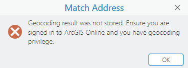

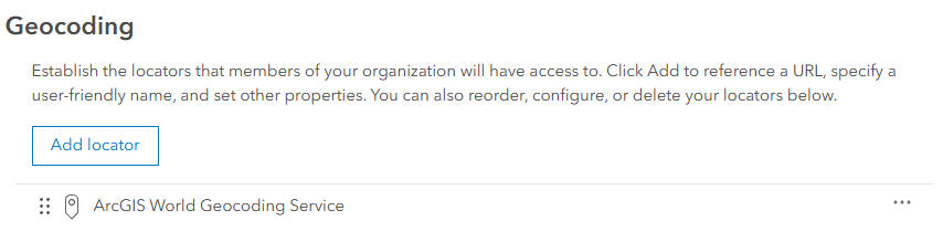

We have an organizational AGOL account with more than sufficient credits. In AGOL, in the Geocoding section of Utility services, it shows the ArcGIS World Geocoding Service. However, when we go to geocode in ArcGIS Pro, the only Input Locator available is the Esri World Geocoder. If we use it, we get zero matches. If we try to rematch, we get a "Geocoding result not stored. Ensure you are signed in to ArcGIS Online and have geocoding privilege." After much tinkering, ArcGIS World Geocoding Service now shows, but it still does not work.

a_benitez
Hello! Were you able to get to the bottom of this issue? I'm on 3.6.2 and experiencing the same.
ToddFagin
It was 100% an issue on Esri's end. We worked directly with them to try to resolve it. If I recall, an eventual update is what fixed it. It's been a while though.
