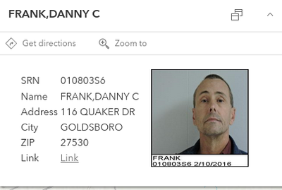

  And the result:
Any of the tables, cells, etc., can take inline CSS with a style tag, to make the table nicer to look at, to improve the spacing between elements. You can even force the height and width of the image to fix that vertical stretch.

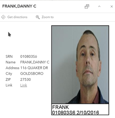

JulioGarrido
This is awesome!!!   Thank you!!!

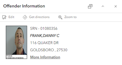

JulioGarrido
The new and improved (Thanks to Josh)
