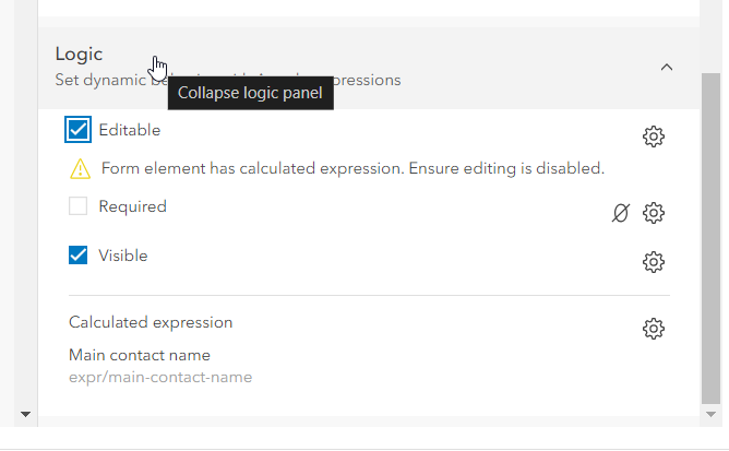

Is there a way to do this? In Map Viewer's Form> Logic if I have a Calculated expression applied (to auto-populate the answer) I have to turn Logic's Editable off.
Are there any work arounds for this? Or is there a road map to allow for editing the output of Calculated expressions?

@elpinguinothere are some workarounds you could try to make this work in the meantime:
  • Edit the web map item's JSON to make the field editable.
  • Current workaround:
    Create an extra field that determines if the field with a calculated expression is editable or not, given a condition. If the condition is fulfilled and the field can be edited, then the calculated expression is not applicable.
    Drawback: need to add extra fields to your schema just to handle this.
    Example: street name calculated based on intersecting features

Hi @bbollin .Thank you for your reply and providing workarounds. I tried editing the web map's JSON in ArcGIS Assistant, but couldn't get the auto-populate to work in conjunction with the editable setting.
This is what I tried. In the CommsRecord layer, tested on Contact_First_Name field. In Map Viewer applied this arcade expression to pass the attributes. I didn't name the relationship at the time of publishing, so that's why it is ''.
// load all related features
var related_features = FeatureSetByRelationshipName($feature, '', ['PrimaryOccupierContactFirstName'], true)
// select one of those features, here we just grab the first one
var related_feature = First(related_features)
// if there are no related features, related_feature will be null and we will
// get an error down the line, so we need to check that and return early
if (!IsEmpty(related_feature)) {
    return related_feature['PrimaryOccupierContactFirstName']
} else {
    return null
 Turned off editable in Map Viewer Form. Saved Form. Saved Map.
Went into ArcGIS Assistant > Map Viewer item > JSON. Changed "editable" for only this field from false to true.
This is the output if I have the Map Viewer form formatted with editable turned off.
This is the output if I have the Map Viewer form formatted with editable turned on.
