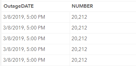

When I publish this FC to AGO, the date changes to what I suspect is UTC:

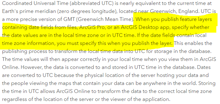

This is the expected behavior, but the documentation also states:
I don't see any guidance as to how I can specify whether the date values are in local time zone, and I don't see any Date/Time settings when I go to publish the feature layer.

Thanks Robert - I figured it out.
The documentation isn't clear that you can only override time settings when publishing from Pro, and not from ArcMap.
