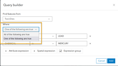

Similar to in the Filter UI, the trick for switching from AND to OR is switching the dropdown under "Where" from "All of the following are true" to "One of the following are true".
These statements apply to any expression at the same level of indentation.

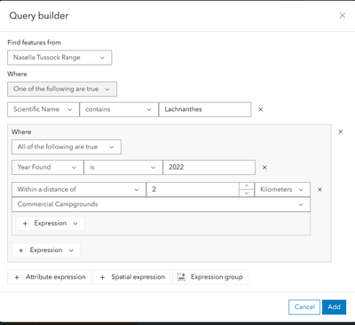

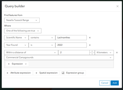

So in the following example, we will find patches of grass where either the scientific name includes 'Lachnanthes' OR the year of the observation is 2022 OR it is within 2 km of a campground:

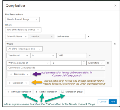

In order to have nested query groups, you can use an Expression group.
Let's say we wanted to update our example to find patches of grass where either the scientific name includes 'Lachnanthes' OR  [both the year of the observation is 2022 AND it is within 2 km of a campground].
In that case, after the first expression, we would add an Expression group within which the second and third expressions would be listed, with their own WHERE operator.
This reads as patches of grass where either the scientific name includes 'Lachnanthes' OR  where all of the following are true: the year of the observation is 2022 AND it is within 2 km of a campground.
