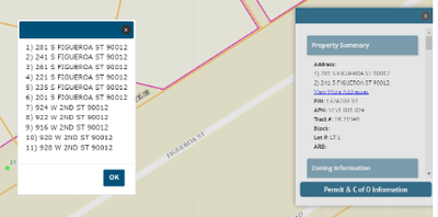

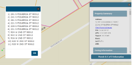

I am trying to setup a popup such that I would like it to show more addresses (if greater than 2) as a clickable, like a clickable text (view more addresses). Below code is an attempt which opens up a new blank browser window in Experience Builder. Since the map is embedded in an Experience Builder app.
Purpose:
The popup should initially show only two addresses followed by a clickable text. If the user clicks on that text only then more addresses will show.
Desired output:
Current code:

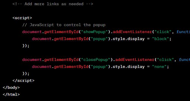

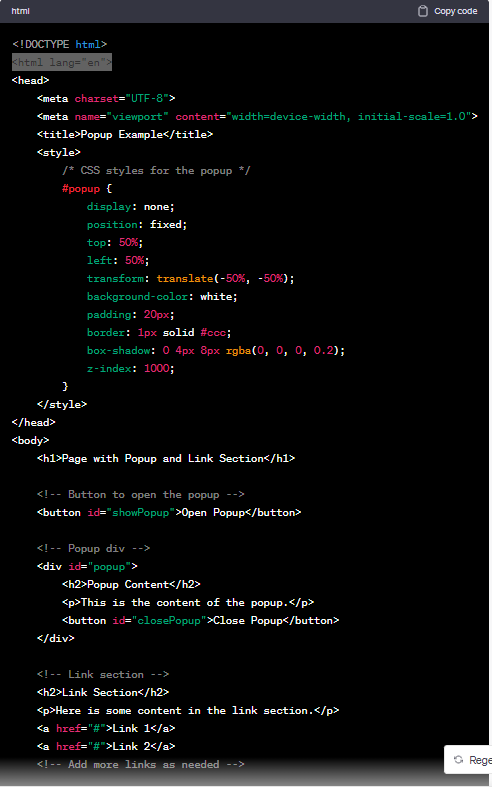

Hi @KenBuja happy Monday, hope all is well so, I did some searching and found an HTML snippet shown below, do you think this can help in what I am trying to achieve? Thank you so much time and help 🙂
<!DOCTYPE html>
<html lang="en">
<head>
    <meta charset="UTF-8">
    <meta name="viewport" content="width=device-width, initial-scale=1.0">
    <title>Popup Example</title>
    <style>
        /* CSS styles for the popup */
        #popup {
            display: none;
            position: fixed;
            top: 50%;
            left: 50%;
            transform: translate(-50%, -50%);
            background-color: white;
            padding: 20px;
            border: 1px solid #ccc;
            box-shadow: 0 4px 8px rgba(0, 0, 0, 0.2);
            z-index: 1000;
    </style>
</head>
<body>
    <h1>Addresses</h1>
    <button id="showPopup">Show Popup</button>
    <!-- Popup div -->
    <div id="popup">
        <h2>Selected Addresses</h2>
        <p>Address 1: 123 Main St, City1</p>
        <p>Address 2: 456 Elm St, City2</p>
        <a href="#" id="showAllAddresses">Show All Addresses</a>
    </div>
    <!-- Link section for the rest of the addresses -->
    <div id="restOfAddresses" style="display: none;">
        <h2>Rest of the Addresses</h2>
        <p>Address 3: 789 Oak St, City3</p>
        <p>Address 4: 101 Pine St, City4</p>
        <!-- Add more addresses as needed -->
    </div>
    <script>
        // JavaScript to toggle the popup and link sections
        document.getElementById("showPopup").addEventListener("click", function() {
            document.getElementById("popup").style.display = "block";
            document.getElementById("restOfAddresses").style.display = "none";
        document.getElementById("showAllAddresses").addEventListener("click", function() {
            document.getElementById("popup").style.display = "none";
            document.getElementById("restOfAddresses").style.display = "block";
    </script>
</body>
</html>
