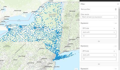

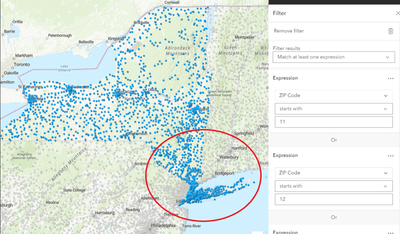

At the map level, you can apply a Filter.
From there, you can build an expression like this:
That way, the data is already filtered when the map loads in your Dashboard.
You can apply the same kind of filter in the Dashboard itself, but on a per-widget basis. Probably best to do it in the map.

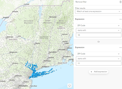

Thank you for the photos, super helpful. What if I only want to  show a specific portion of NY?
jcarlson
MVP Alum
Play around with the filters and see! You should be able to get pretty close with some broad "begins with" filters, then some more specific ones to get anything else.
For instance, "starts with 10 Or starts with 11" gets you Manhattan and the southern end of the state. If you need more beyond that, you can just add more specific statements to the filter to get them.
