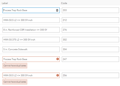

Why can't  you have duplicate labels in a domain in ArcGIS online?  I understand why you can't have duplicate codes but the label is just text.  It shouldn't matter what the label is since the label isn't what is actually stored in the database.  I was able to create a domain in ArcGIS Pro with duplicate labels and publish to AGO.  It seems that if this is an issue in AGO why would I be allowed to publish the layer with a domain that has duplicate labels?
Now I know someone may be wondering why I would want two codes with different values to have the same label.  I'll do my best to explain.  Below is list that I use in Survey123:

This is actually what I use in Survey123 but the first two columns are the actual domain in my bid item table in my hosted feature layer.  In Survey123 the list is filtered based on the type of component the user has selected.  If the user selects ABR they only see rows 203 and 212 and then additional processing occurs like looking up the bid item cost from a CSV file that depends on this selection.  This was originally designed four years ago and has been used successfully since.  However, a new contract was recently awarded and there are now additional bid items and different costs.  Many of the bid items remained the same.  My plan was to assign a new numeric ID and just append these values to my existing bid item domain.  It was going to be a big list but my end users wouldn't see it that way as I could filter it all in survey123 based on the component type and, now, a contract number.  That's when I discovered that I couldn't have duplicate labels in the domain.
Is there a way to create a new domain and replace an existing domain with the new one?  Any suggestions or hep would be greatly appreciated!

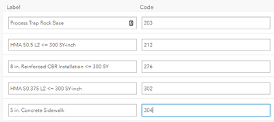

Put in all the ones that do not have a duplicate label and save.
