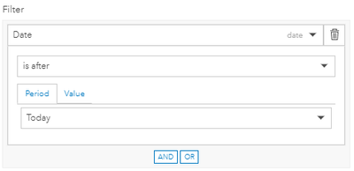

Currently this isn't in the filter component. Does using an expression like this help?

Thanks @RussRoberts, that works for the web, though we see no data at all in field apps (Explorer, Field Maps).
m3
I too see this.  The filter works in the web map but renders nothing in Field Maps.
My workaround is to create a symbology expression by date with the data I want hidden in the 'other' area and turned off.
It would be best if ESRI could fix the Field Maps filter
