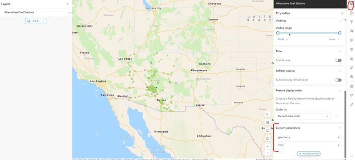

You can define custom parameters for a layer in the settings of the web map:
Documentation for the types of parameters accepted can be found here:
https://developers.arcgis.com/rest/services-reference/enterprise/query-feature-service-layer/#reques...
In my screenshot example, I used inSR = 4326, and geometry=-114.8165,31.3322,-109.0452,37.0043

Katie_Clark
MVP Regular Contributor

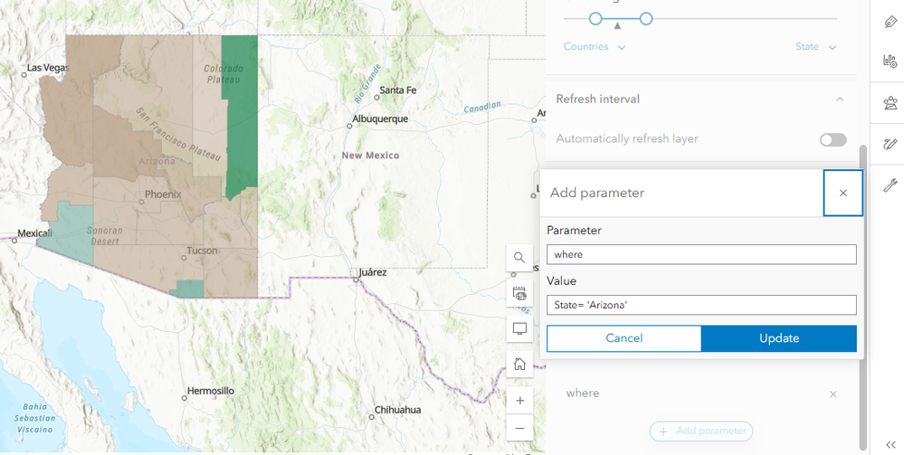

DebapriyaPaul
Hi @MeleKoneya , to filter by a specific state name, the custom parameter in Map Viewer could look similar to the following example,
custom.pngNote: Use the Fields panel in Map Viewer to confirm the Field name that contains State Name information.
