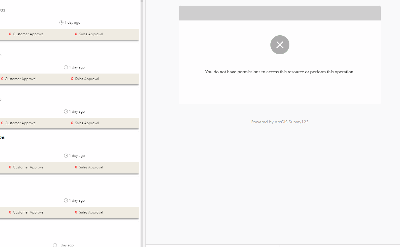

DembaEstadual
Hello @neomapper,
I encountered the same error in Survey123 forms built into ArcGIS Dashboards. Apparently, Dashboards underwent an update during maintenance on 03/22/2022 and as a result it stopped passing the token to the embedded form, causing it to no longer load forms that are not publicly shared.

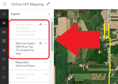

Esri Notable Contributor
Thanks, can you retest today? I cant seem to reproduce the popup issue with your maps yesterday
neomapper
If you open the map at the top there will be 2 layers turned off. When you turn these on it prevents all the layers from displaying a popup in the map
RussRoberts
Thanks, looks to be a different issue from yesterdays one. This one I can reproduce with my own test case but it looks like its due to the itemids  for the layers you are trying to get the popup from in the web map no longer exist but the feature services are still around. Was this an intentional change?
ErikFin
Hello @neomapper in reference to your Dashboard comment, I am also having the same error with a Survey123 form embedded in a dashboard. Based on the comment by @DembaEstadual, I confirmed that the survey works normally after sharing both the form and it's associated feature layer publicly - but unfortunately this is not a feasible solution based on my project.
