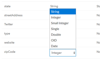

When you add the dataset originally, there should be a way for you to indicate what kind of fields you have:
You could also create the layer first and append to it using the CSV.
