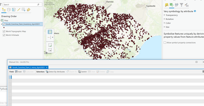

Sorry. It's a point feature service with editing and edit tracking enabled. I click edit and go to click on the map to create the point and nothing happens. So I exported and brought into arcpro. I go to create a feature. It appears then immediately dissappears. I open the attribute table and it looks like this, and says I have a feature selected so it did create but isnt visible and the table doesn't show contents.

Ok, I have not figured out the issue, but my work around was to export the service into a blank geodatabase from arc pro. Then, disable m values, export into a copy of the service geodatabase I exported (removing the one that exported from the web that had no attributes). This fixed the issue of creating features in arcpro. Now I'm overwriting my service and hopefully it will work. Why does this randomly happen on AGOL? Nothing has changed on my end in months.
