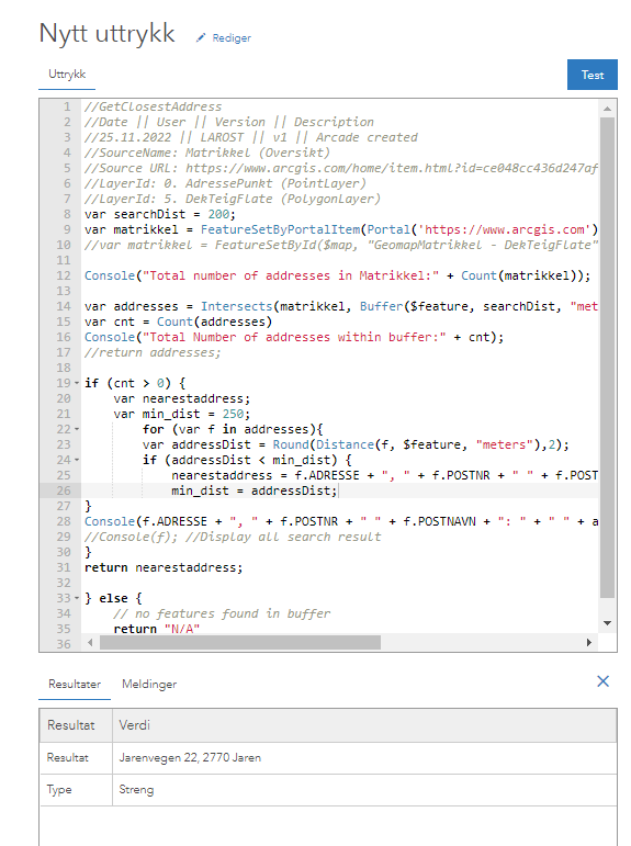

ArcadeEditor gives me correct result:

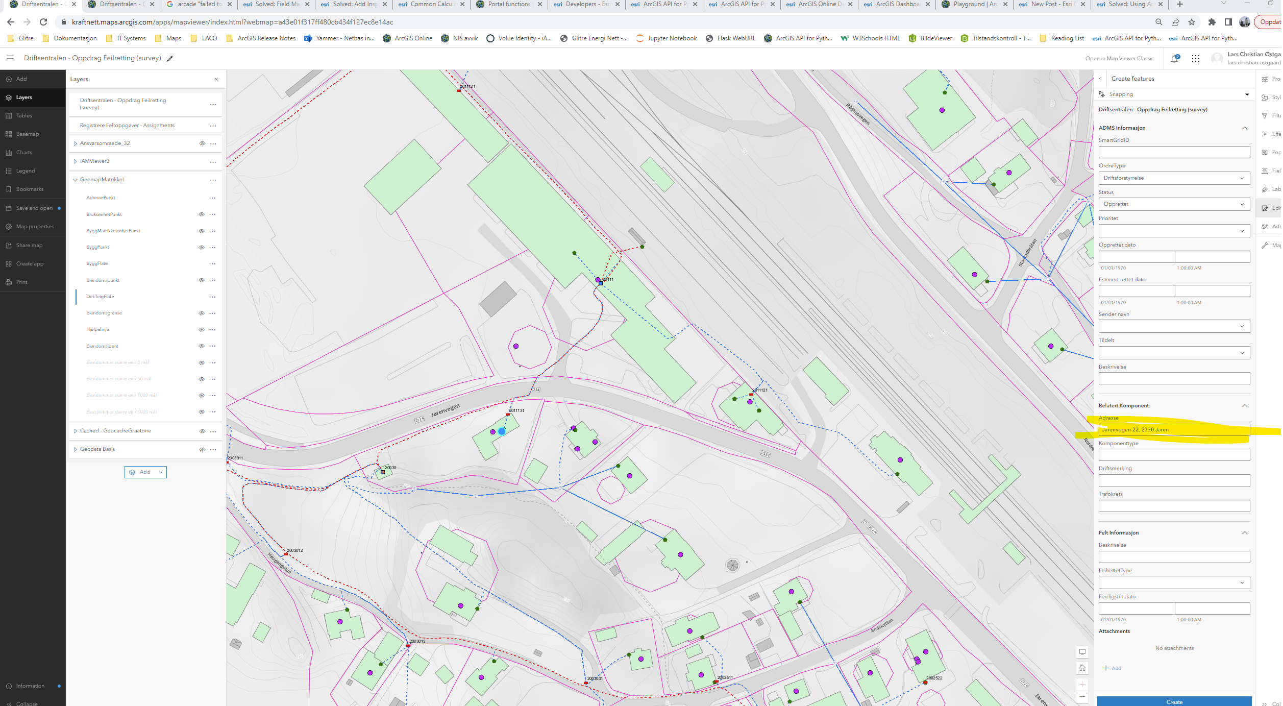

SmartForm in Map Viewer gives me correct result:

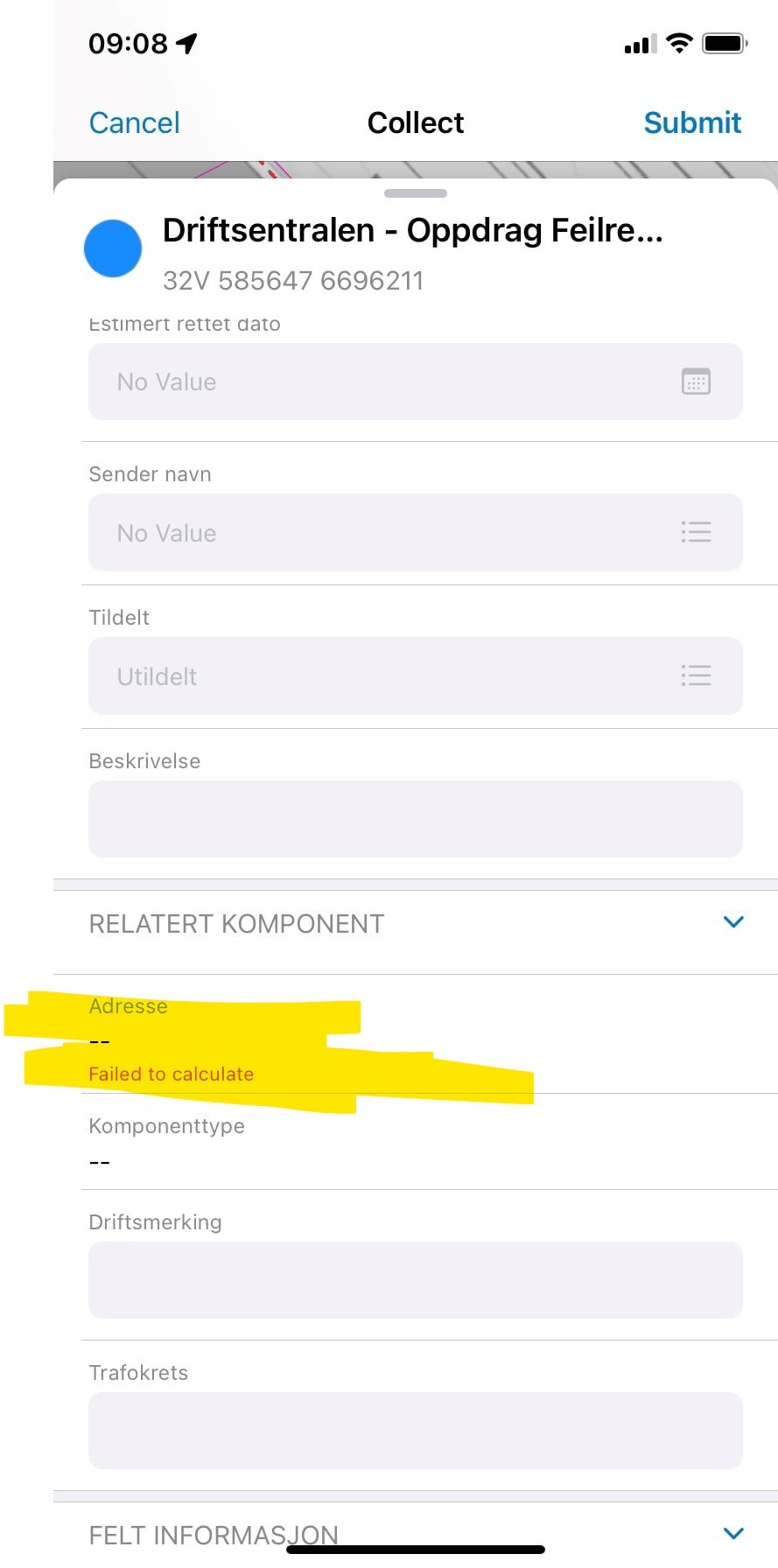

Field Maps Mobile App gives error message failed to calculate:
There is no problem in getting the location in the form.
