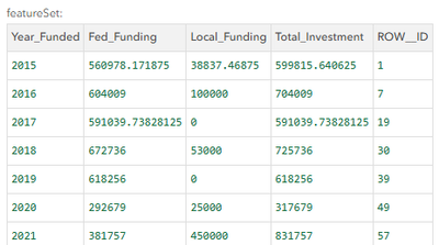

@KenBuja can I get your help one more time? Here is my current result table:
I need two more columns: one that divides the Fed_Funding category by the Total_Investment category and one that divides the Local_Funding category by the Total_Investment category.

If you had one entry per year in your data, you could have used the same GroupBy to create the two new columns dividing the sum of the federal (or local) investments by the sum of all investments. However, that won't work with multiple rows per year.
Instead you take the grouped FeatureSet and run another GroupBy to calculate those numbers.
var grouped = GroupBy(fs,"Year",
      expression: "Fed_Fund_1 + Fed_Fund_2 + Fed_Fund_3",
      statistic: "SUM"
      expression: "Local_Fund_1 + Local_Fund_2 + Local_Fund_3 + Local_Fund_4",
      statistic: "SUM"
GroupBy(grouped, "Year",
    { name: "Federal Funding", expression: "Fed_Funding", statistic: "Max" },
    { name: "Local Funding", expression: "Local_Funding", statistic: "Max" },
      name: "Total Investment",
      expression: "Fed_Funding + Local_Funding",
      statistic: "Max"
      name: "Federal Percentage",
      expression: "Fed_Funding/(Fed_Funding + Local_Funding)",
      statistic: "Max"
      name: "Local Percentage",
      expression: "Local_Funding/(Fed_Funding + Local_Funding)",
      statistic: "Max"
