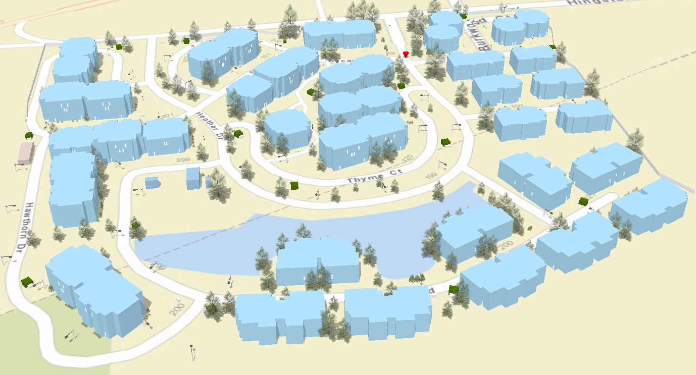

Thank you for the reply Russell, please accept my apologies for the delay with my response.
I had to call ESRI support and get some help with this one and it was perplexing to them too.
It never did work straight up from ArcPro and I had to use the
Create Layer Object 3D Scene Layer Package tool for each layer that I wanted to add to the scene noted above.
This scene may not be available for viewing in the days to come to I'll post a snip here with it too, as to answer your question.
