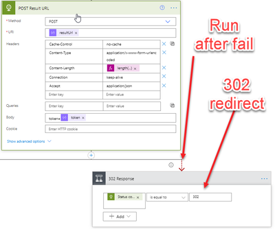

PhilLarkin1
As I mentioned before, it would be best to create a new question. There are some resources on this forum to answer this question. Here is a question I posted awhile ago. It is the same as yours!
Solved: HTTP Redirect when calling changeFiles JSON with P... - Esri Community
The redirect is expected. Set up a condition that is trigged on the failure of your POST to changeFiles. The POST is expected to fail because Power Automate classifies the 302 code as a failed state. Weird, but that is the way it is.
JulieK
oh my, I see you had the same issue. Now that you say it, I think I have seen this thread out of millions of threads I visited. Wonder why this is going so complicated. Sorry I keep pinging you but you are the only one who has this actually working 🙂 Thanks so much Phil...appreciate it!
I wish ESRI would have a blog on this for Power Automate too...much needed.
