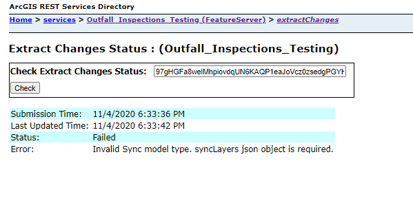

I'm receiving a strange error when I try to run extractChanges on some of my Hosted Feature Services.  I'm pretty new to using the REST API but had everything working yesterday via Integromat HTTP requests and JSON.
Sync is turned off on this service as well as the others that are experiencing the issue, but change tracking is turned on.
Thanks for any help.
 Error received from Extract Changes

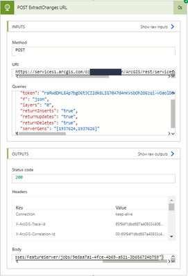

When Posting the extractChanges via Power Automate, the job ID returned always leads to the Invalid Sync error. When I submit via the Services Directory the job ID leads to a successful status and I get the edits back via JSON.

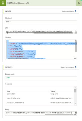

This is showing a POST to the Extract Changes endpoint: https://services1.arcgis.com/<yourOrgID>/ArcGIS/rest/services/Addresses/FeatureServer/extractChanges
The response includes the statusUrl property with a job ID: https://services1.arcgis.com/<yourOrgID>/ArcGIS/rest/services/Addresses/FeatureServer/jobs/9edaa7a1-4fce-4b69-a521-3example9

Hey @PhilLarkin1 ,
When I send the Statusurl along with the generated token, I get an error saying ' The length of the URL for this request exceeds the configured maxUrlLength value.'. I am using HTTP connect with GET and sending the StatusUrl&token=generated token.
Did you experience anything similar? Wonder where I am going wrong with Power Automate.

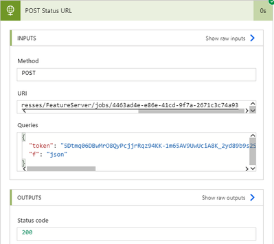

PhilLarkin1
Try using POST to the FeatureServer/jobs/<guid> endpoint. Your token and format key/values should be sent as queries.
JulieK
Yes, I tried that. That leads me to 'Unable to synchronize replica. Invalid Sync model type. syncLayers json object is required.' The feature service has the sync option disabled but I get the same error when it is enabled too.

When I do it manually from the REST api, I am able to get the json file fine. In a browse, the statusUrl with token gives me maxUrlLength value error. In PA, I am able to send the changeurl to receive  statusurl fine but when I send statusUrl using GET, it gives the maxUrlError and POST gives me  Invalid Sync model type error.

I had some issues when my query values were not setup properly on my POST to /extractChanges. Try sending returnInserts, ReturnUpdates, and returnDeletes if these are valid operations on your Feature Service. You might also want to leave your layers value empty if you are only processing edits from a single layer. Worked for me.
Example Query:
  "token": "5Dtmq06...",
  "f": "json",
  "layers": "",
  "returnInserts": "false",
  "returnUpdates": "false",
  "returnDeletes": "true",
  "serverGens": "[1949280,1949301]",
  "dataFormat": "json",
  "returnAttachmentsDataByUrl": "true"
