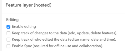

--For the feature layer, edting is enabled.

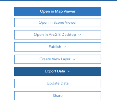

ChatGPT led you astray. 'Export data' does not appear in the Layer options menu in Map Viewer.
However, (when export is enabled) Export Data does appear on the item details page for the feature layer. Here you can download the layer, then you could re-publish a new copy and make any desired changes such as deleting features so that this layer contains a random subset of features for your project.

I would suggest that creating a view of the hosted feature layer is the way you want to go. Any construct within a webmap is by definition temporary and dependent on the webmap itself. If somebody deleted it then your item would be gone.
Go to the hosted feature layer you want to create your subset from and click "create view layer" and follow the instructions through. It will create a subset that is intrinsically linked back to the parent layer, but filtered in the way you define
