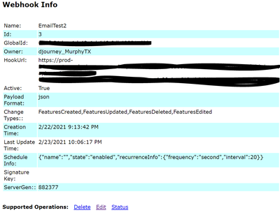

Danielle_Journey
@PhilLarkin1  That's what I did.  Still nothing when I test it:
PhilLarkin1
You might want to edit your Change Types to call out the subscriptions directly. I'd also double check that the HookUrl is the same on AGOL as in your flow.
Danielle_Journey
I made the update to the Change Types and re-copy/pasted the Hook Url.  Still no test results after making a change to the feature service.  I am so stumped on what I am doing wrong!

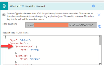

I wanted to add to the great information already provided here.
To avoid Bad Requests, try removing any actions that sends alerts or messages or otherwise connects to Microsoft Office or teams, mail etc.
Due to a bug (wrong content-type) I have found that these actions can cause Bad Requests when getting requests from a live Feature service WebHook trigger. This can be deceiving as it  usually works well in test mode (when using a previous successful test request).
If you have a need to have alerts as par of your workflows, maybe a workaround would be to have another flow handling only the alert/message piece.
I was able to create a working Flow package (with no alerts) that completes the following workflow:

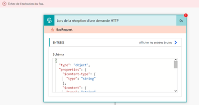

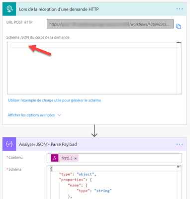

For the past few days, I have encountered an error on the first module When a HTTP request is received : BadRequest.
This issue seems to come from the JSON schema of the request body predefined during my configuration. @Anonymous User, would Esri have recently modified the request sent by the webhook (e.g Content-Type header)?
I solved this issue by removing the JSON schema of the request body (leave blank) in my first module.

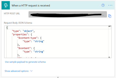

Hi @hgaignard I was not able to repro this with JSON schema in the HTTP module:
  "type": "object",
  "properties": {
    "$content-type": {
      "type": "string"
    "$content": {
      "type": "string"
    "$formdata": {
      "type": "array",
      "items": {
        "type": "object",
        "properties": {
          "key": {
            "type": "string"
          "value": {
            "type": "string"
        "required": [
          "key",
          "value"
I tried a couple of different change types with no issues. Are you still seeing the issue?
Thanks,
-Peter
PhilLarkin1
I just reproduced the error with the schema you provided.
The issue stems from flows which also include connectors like Teams, Outlook, etc.
hgaignard
@PhilLarkin1, I confirm, if I delete my last Outlook module, I no longer have the "BadRequest" error for the first HTTP module with a predefined JSON schema.
To keep the Outlook module, I need to remove the JSON schema from the first HTTP module.
But it worked before...
