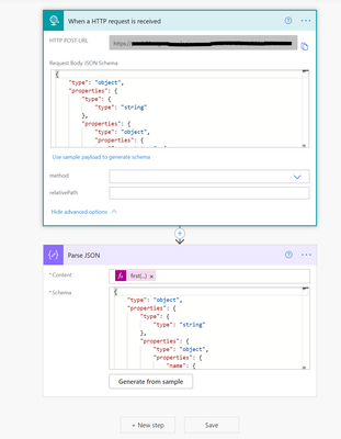

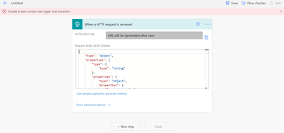

Hi @hgaignard
I'm trying to follow your example, but I am having trouble running the test.  I cannot do the "Automatically" test option because I do not have a recently used trigger. And when I try to test "Manually" by creating an update to the hosted feature service... nothing happens.  Is there a different way to run a test in order to get the output that you are showing above?  I've set up my flow similar to yours.  I do not understand how you test just the "When a HTTP request is received".  Even if I try to save at this point I get an error message.  Any help would be much appreciated!!  Thanks
PhilLarkin1
Hi @Danielle_Journey
Your Request Body JSON Schema appears to be incorrect. I struggled with this piece of the puzzle for quite some time! Copy the example @hgaignard gave in the first code window of his post into the Request Body window you show in your screenshot. Notice the '$content-type' key in his example.
Danielle_Journey

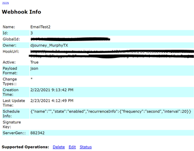

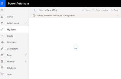

Thank you @PhilLarkin for catching that!  I pasted his sample payload directly into the request body, I had pasted it in the "generate schema" window earlier.  Now to test... I selected test manually in Power Automate, then I went into AGO in a new window and created two updates to the hosted feature service (Web hook is enabled with correct hookurl).  It's been several minutes and I'm still getting the spinning donut in Power Automate.  Any other ideas?  Thank you!
