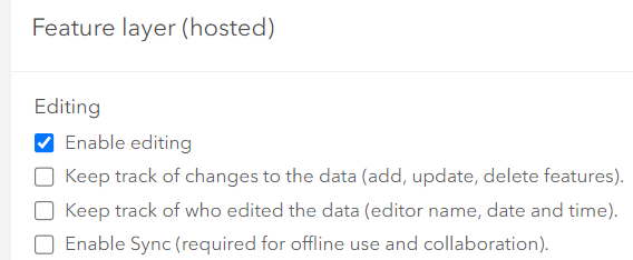

I rebuilt the feature template using the Map Classic (why isn't this available in the new map yet, it's August 2023??) but that didn't work. I tried turning on/off the "Keep track of changes to the data (add, update, delete features)." but it didn't fix the problem. I then tried turning off/on all of those features (Enable editing, Keep track of changes..., Keep track of who... Enable Sync... ). I also rebuilt the Spatial Index (not sure if necessary).
Then it finally started working again.

Hi there! I followed your advice because the previous solution didn't work for me either. I wanted to thank you and share what I did in case someone else encounters the same issue.
Here's a bit of background: I have a hosted feature layer in ArcGIS Online consisting of point locations for mine sites. This layer had a lot of fields, and I decided to clean it up by deleting many of them. I deleted the fields using the "Data" tab in ArcGIS Online, selecting the fields and deleting them from there, rather than doing it in ArcGIS Pro. Over time, I've found that managing layers hosted in ArcGIS Online works better for me using ArcGIS Online commands instead of ArcGIS Pro commands—if that makes sense. Things just seem to stick better that way.
So, back to my story. I followed Mr. Alex's suggestion and adjusted the settings as shown in the image. I’m not sure if that alone fixed the issue, but what I did next definitely helped. I opened the layer in an ArcGIS Online map, went to a point, and updated an attribute. It allowed me to save the change. Then, I was able to load the layer into ArcGIS Pro and save any changes I made.
I wanted to share this extra bit of information for anyone who might come across this post. I hope it helps!
