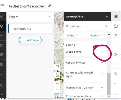

I have a web map that I created in Map Viewer this year that our field crew has been using for data collection. This past week when I opened Field Maps to show a new field crew member how we collect data, the Add Item button was no longer showing. I eventually I logged into ArcGIS Online and opened the web map in Map Viewer (not classic). I went to one of the previously editable layers, selected Show Properties and Enable Editing was off. What would make it toggle off in the web map by itself?  I toggled on Enable Editing (it did turn on and I could even edit a point), saved the web map, closed it to looked at another layer in my table of contents. I went back to view the web map in Map Viewer and Enable Editing was toggled off. The setting is enabled as long as I am viewing the web map, but if I leave the web map Enable Edits doesn't stay enabled for the layer. I made a new web map and a new hosted feature layer with the same results. In Field Maps it says the map is editable and not read-only, but no Add Item button.

I did try republishing yesterday and I tried again just now from Pro to ArcGIS Online. Shared a web layer. Checked on enable editing, enable sync. Published to ArcGIS Online. In ArcGIS Online the hosted feature layer settings show that edits and sync are enabled. When I open the hosted feature layer in Map Viewer, the layer properties has Enable Editing toggled off. I can toggle Enable Editing on and add a point in ArcGIS Online from the web map, but if I save the web map, close, then open, Enable Editing is toggled off. Any insights?

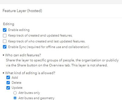

JFujikawa
My initial issue was that the Add Item button in the Field Maps app wasn't showing any longer. Then I went to look at the underlying web map and found this issue. I attached the hosted feature layer shot of editing enabled and in the web map where enable editing does not remain enabled.
