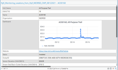

I am having similar issues. I have a feature layer in AGO with Iframes that are displayed in the pop-up window. I made a few data updates to my feature layer in August editing the layer in Pro (no changes to teh iframes) and now my iframes only show-up as code in the AGO pop-up. I have even tried overwriting the original layer and republlishing the layer on AGO and have the same issue.  In Pro the iframe is visible. See snapshots below.
Pop-up in ArcGIS pro
Pop-up in AGO

Hi Leila,
Just confirming that the exact thing is happening to me. I checked the same Hosted Feature Service in Pro and the iframe displays the linked content correctly there - but continues to only display the iframe text when opened in pop-up in Web Viewer Classic (and is totally blank in the New Map Viewer)
In this case I'm linking to an interactive panorama hosted via imgur. I haven't been able to find an active bug case for this issue.
