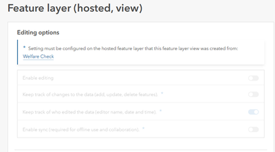

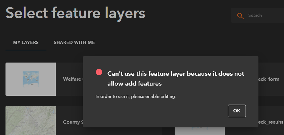

I have a question regarding in issue I am having adding a feature to Quick Capture. (My ultimate goal is for a non-ESRI login user to be able to update a layer with pertinate information, so if there is a simpler way to do this, I am all ears.) I am trying to use Quick Capture as outlined by this video. I am trying to create a disaster welfare check system in which a resident of my county would fill out a Survey 123 so they could request a welfare check for a resident of our county. I am creating a Quick Capture survey for the County employee to fill out describing the outcome of the welfare check. I am using a joined view of these two layers as described in the video. My issue is that I keep getting errors when I try to use my joined layer in Quick View.

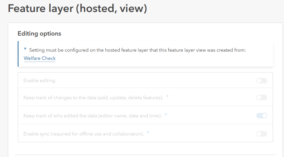

I click on the joined view layer and see this in settings...

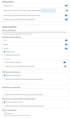

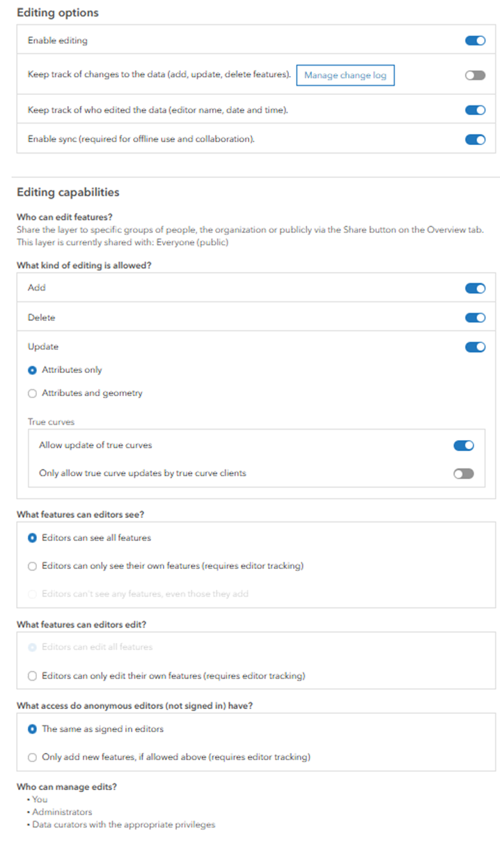

I think click on the root layer to change editing, but every editing option is turned on.

You can't enable editing on joined view layers
https://doc.arcgis.com/en/arcgis-online/manage-data/manage-editing-hfl.htm
You may also encounter issues with sharing data for public collection. There may be ArcGIS Online administration settings you need to enable.
I believe you also need a hub premium if you want to use quick capture for public users:
https://doc.arcgis.com/en/quickcapture/faq/faq-prepare.htm
