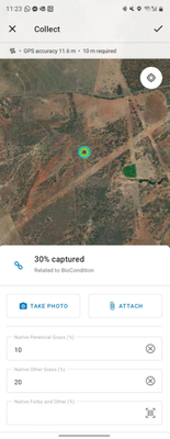

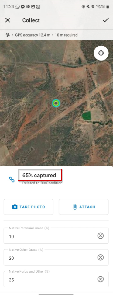

I was recently demonstrating a layer that I was building when I noticed that an arcade expression that I had built and was using in the popup title was dynamically instant updating as soon as you clicked out a field. My users loved this feature as they could instantly see what total percentage, the form was completed while editing. The example below is a small subset as there are a lot of fields in the total form:

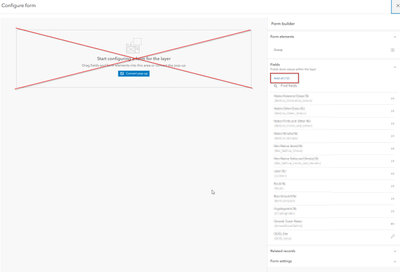

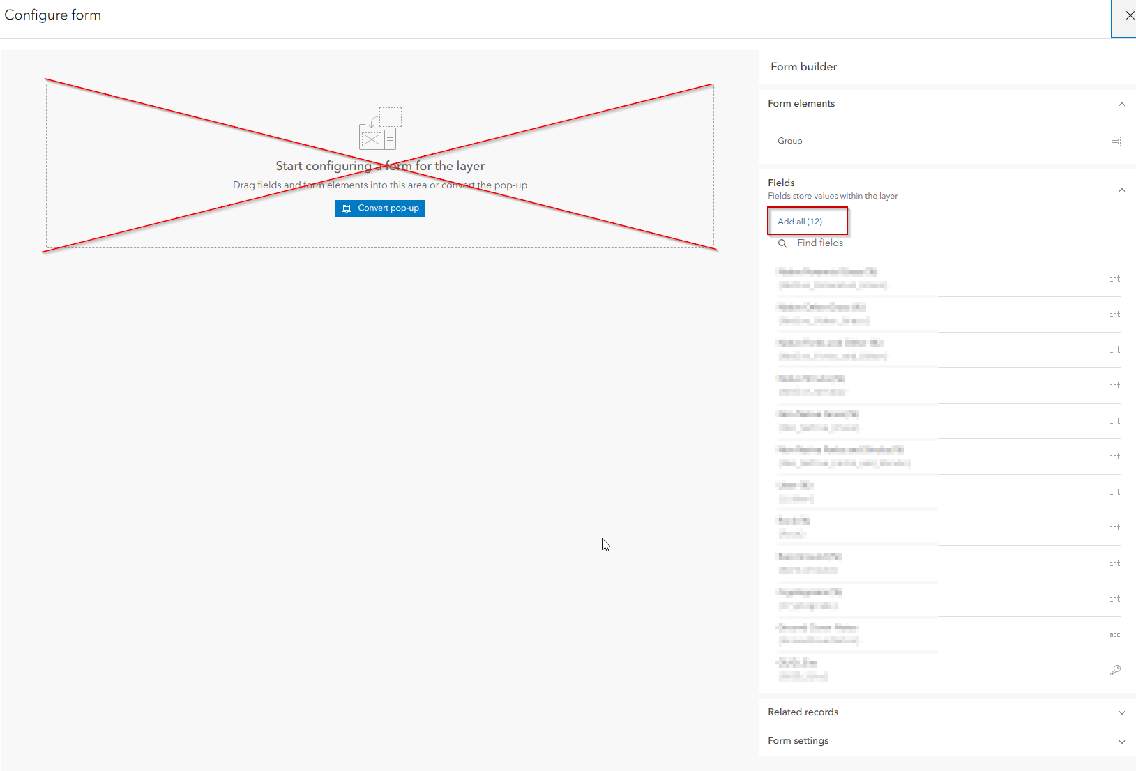

  2. In Map Viewer form builder, the most important step, DO NOT click 'Convert a popup' otherwise this functionality does not work. Configure your form manually by 'Adding All' or adding whatever fields you need. tiztrain_3-1704710352602.png
    • Do not touch the title, if you edit the title you will not get the instant calculation working and will need to reset the layer to original.
