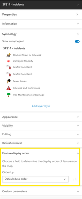

Have you tried enabling the option to Display features by value order under the Types (Unique symbols) style options in Map viewer?
We could also configure Feature display order to define the order in which features are drawn on the map. It can be set on any numeric or date field in your data. To access the setting, open the Properties pane for the layer >> click Feature display order

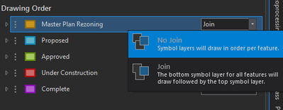

When you say shared as a map layer, are you saying you created a map service, feature service, or did you create a hosted feature layer copy on Portal or AGOL?
If publishing a map service or feature service from ArcGIS Pro, you could potentially use the Symbology pane > Symbol Layer Drawing tab and set the draw order here, and I believe the map viewer should honor these draw settings. If publishing a feature service, it might warn you that not all advanced symbology options may function, but I think you can just ignore it in this case. Symbol layer drawing also lets you join/merge (or not) the sub-layers within each symbology so things blend together. But you can disable that function by changing Join to No Join. Feature Services sometimes simplify those multi-level symbologies so I think that's what it's warning you about.
