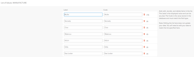

I don't have a link to a blog, but let me show you what I did step by step. Hopefully it helps.
On the Data tab of the feature layer, top right corner will have "Table" & "Fields", select "Fields".
It will take you to the attributes fields, select the attribute (in your case "Type") and on my example I'd select "Manufacture" or any other attribute that has a drop-down list.
You will see the "List of Values" in the attribute(s), select "Edit"
And it'll take you to the actual list to edit. Maybe the person who originally set up the feature layer did the Label = 1, Code = Culvert. This is how you would find out how the list is set up. Now if it's Label = Culvert, Code = Culvert and still showing up as a digit, I'm not too sure about that.

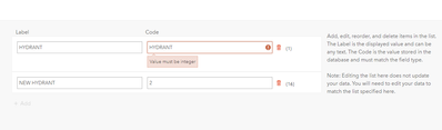

Did you set the list of values as "Label = 1, Code = Culvert"? If so, you can go back and update your list of values as "Label = Culvert, Code = Culvert" and when the data is downloaded/exported you won't have to worry about it showing up as 1, 2, 3. I had a similar issue too and resolved it that way (see photo).

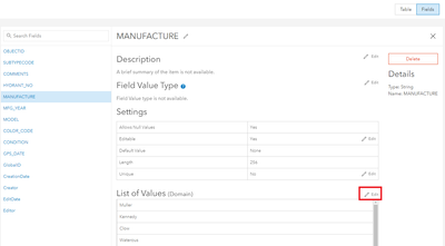

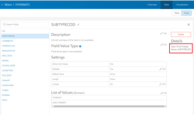

Thank you! I believe that solution would work. Unfortunately, the field in this table is just an integer value and was not created as a list of subtypes as I had assumed it was. I find this really bizarre since the pop-ups show the text value, not the numbers and there doesn't appear to be any special pop-up configurations.
fjramos

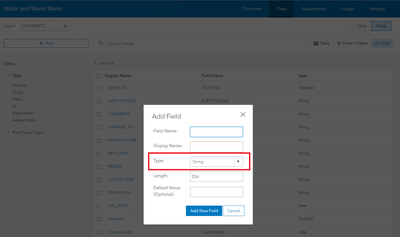

Interesting. I wonder if the feature layer was created from an import or if it was created from scratch on AGOL. The issue I ran into, which was kind of similar, was trying to take a shortcut and importing all our existing shapefiles, that way I didn't have to recreate all our shapefiles into feature layers from scratch. It worked to an extent, but some of the feature types (attributes) were auto-created as small integers and limited on what we could do with them in AGOL. For example, not being able to use text in the code, which would cause all exports to have an integer(s) on the tables, since the feature layer was created using the configuration of the old shapefile. You may have to recreate your feature layers, maybe create one as a test with a feature type as a "string", create a list, place some points on the map viewer, then export and see if that works for you. If it does, then recreating may be the way to go. I know it will be time consuming, but it will be worth it. Also make sure when recreating a feature layer everything is how you want it, some stuff can't be edited after the feature layer is created, like the "field type: string, integer, date, etc." or a "default value". Best of luck!
(Example: this is my original hydrant import from shapefiles)
What I ended up doing is just recreating all our shapefiles from scratch on AGOL and made sure when adding a field (attribute) I left it as a "String" that way an editable "List of Values" appears on a field.
