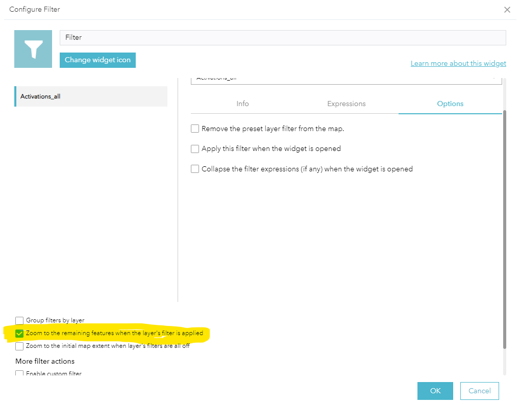

Hi, I am trying to figure out how to configure Filter widget of Experience builder so that the remaining features are to be zoomed when the filter is applied.
I know we can set this up in WebApp builder; however, I have not been able to find the way of setting this up in Experience builder.
In WebApp, we can configure this as per picture below. Does anyone know how to set this up in Experience builder?
Thanks in advance for help!
