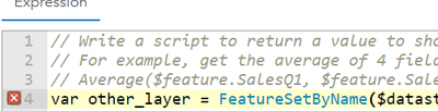

Hello,
Is it possible to access features from another layer in the same ArcGIS Server map service using Arcade?  The map service layers were added to the web map all together and not individually. I'm thinking no since no global variables are available.
Brandon

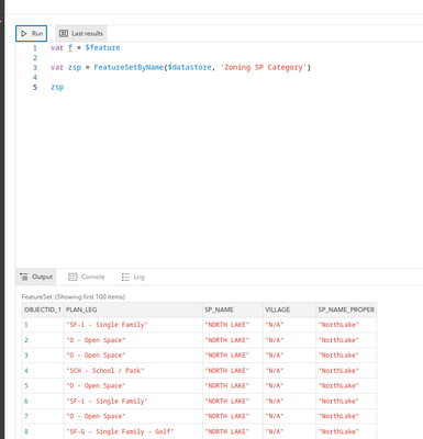

I think it has to do with it being a MapServer? Usually if you add your layer to the map using its layer ID, it will behave like a FeatureServer item.
Try adding the Zoning layer using its URL, https://arcgis.gis.lacounty.gov/arcgis/rest/services/DRP/ZNET_Public/MapServer/4
With that in the map, the expression builder should have access to the usual globals. Seems to work over here!

Hi Ken. I tried $datastore prior to posting my issue and got an error saying it wasn't defined.

Where are you trying to implement this? If they're all in the same service, you ought to be able to use the global $datastore to access the other layers, as in the function FeatureSetByName.

BrandonPrice1
Hi Josh. This is for a popup for a layer in the service. The $datastore option returned an error of not defined.
The service is public https://arcgis.gis.lacounty.gov/arcgis/rest/services/DRP/ZNET_Public/MapServer
I was trying to access the Zoning Sp Category layer from the Zoning layer.

BrandonPrice1
That's the only way I could think to do it also. Just wanted to double check. Thanks.
