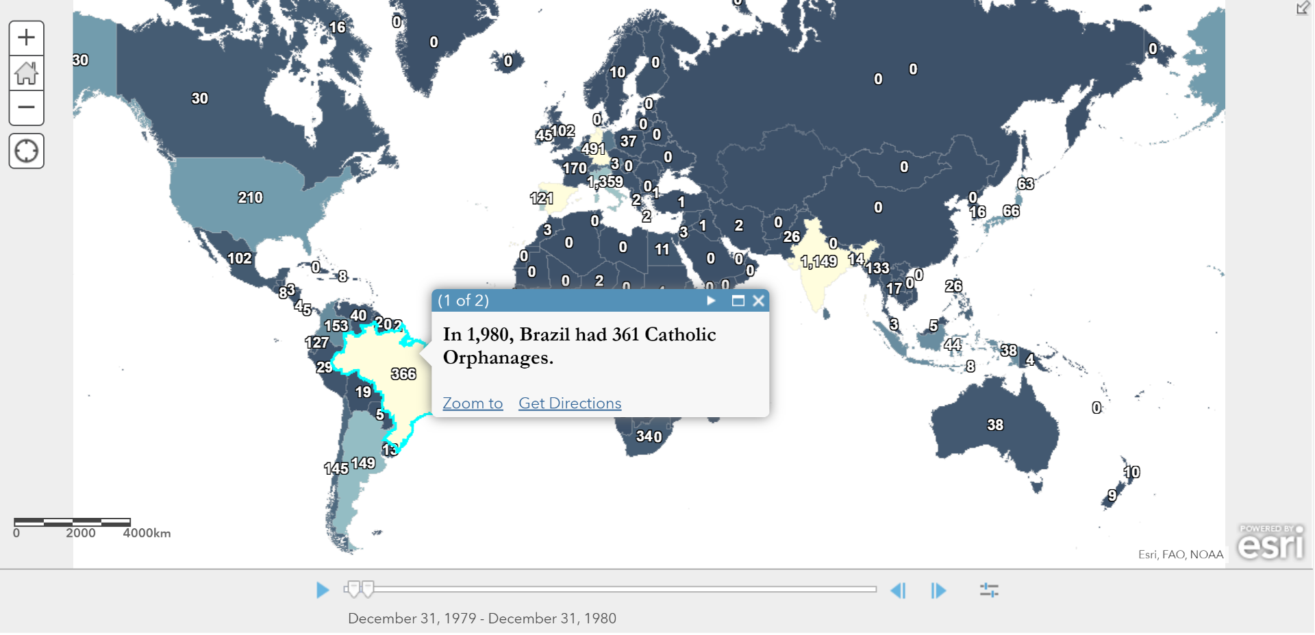

Hi all
I made a time enabled map of data that is the yearly average and thanks to Bushtel Admin posting a workaround was able to edit the interval on the time slider widget so it has the same start time and end time allowing me to display a single year's data at a time. When I go to make the Time Aware app so I can insert my map into a StoryMap however the time slider widget defaults to showing an interval which means it's showing two years of data at a time.
Is there any way to make it so the time slider widget in the only displays a single year's data at a time?

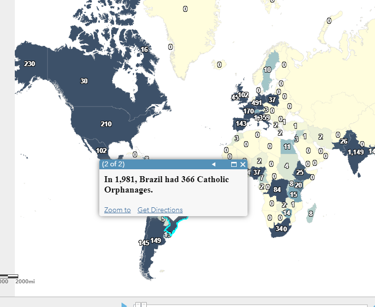

This is an issue that we're having right now too. More than just the slider -- we can see that the data shown in the label is from both the start and end year, and to make things worse, it's different years for different features. Note, Alaska is showing the data for one year as a label while the US mainland polygon is labeled for another. I can toggle between these in the pop up but it's horribly inconvenient.
No slider moved, just the little arrow in the popup:
We plugged in The CSS from @Centre de compétence SITG helped a bit for a moment (thank you!).
But then -- this is where my mind gets blown about trying to fix this -- the entire field of "Orphanages" (displayed above) was erased and replaced with the next year value in the shapefile this is all pulling from. I have never seen anything like this.
But then other attributes, like leprosy colonies, were not hit by this error (yet...)
This is a bit buggy.
