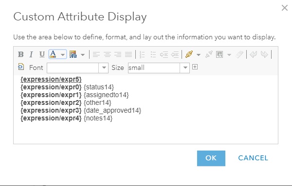

My arcade:
IIF(isEmpty($feature.notes14), "", "Footer") This ideally would be an expression that returns the below set if status14 has any value (or anyone of the predfined values of inprogress, approved, or notapproved with a header of footer
IIF(isEmpty($feature.status14), "", "Status")
IIF(isEmpty($feature.assignedto14), "", "Inspector")
IIF(isEmpty($feature.other14), "", "Other Inspector")
IIF(isEmpty($feature.date_approved14), "", "Date Approved")
IIF(isEmpty($feature.notes14), "", "Notes")
The current attribute expressions:

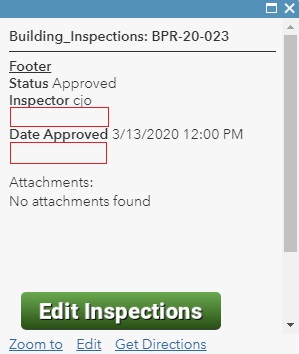

And the current Pop-up: the red box are fields with no value: would like for there to be no break in between fields with values.
If I can do this in a single block of code for each different inspection, that would be fine. I can easily replace the number and the header.

A solution was provided at this post: Conditional Field display with Arcade in Pop Ups (revisited) (scroll all the way down). To make it easier to find for others, see the answer below:
You can use a single expression which reads out all the information and presents the result. The thing that you can't do is apply any formatting at different parts of the result. In you example you have expression single underlined and all expressions in bold. So, I think it might be better to adjust what you already have.
The individual expressions would become:
IIF(isEmpty($feature.status14), "", TextFormatting.NewLine + "Footer")
IIF(isEmpty($feature.status14), "", TextFormatting.NewLine + "Status")
IIF(isEmpty($feature.assignedto14), "", TextFormatting.NewLine + "Inspector")
IIF(isEmpty($feature.other14), "", TextFormatting.NewLine + "Other Inspector")
IIF(isEmpty($feature.date_approved14), "", TextFormatting.NewLine + "Date Approved")
IIF(isEmpty($feature.notes14), "", TextFormatting.NewLine + "Notes")
IIF(isEmpty($feature.status15), "", TextFormatting.NewLine + "Foundation")
IIF(isEmpty($feature.status15), "", TextFormatting.NewLine + "Status")
IIF(isEmpty($feature.assignedto15), "", TextFormatting.NewLine + "Inspector")
IIF(isEmpty($feature.other15), "", TextFormatting.NewLine + "Other Inspector")
IIF(isEmpty($feature.date_approved15), "", TextFormatting.NewLine + "Date Approved")
IIF(isEmpty($feature.notes15), "", TextFormatting.NewLine + "Notes")
...and the text in the pop-up would become a single line like this:
{expression/expr5}{expression/expr0} {status14}{expression/expr1} {assignedto14}{expression/expr2} {other14}{expression/expr3} {date_approved14}{expression/expr4} {notes14}{expression/expr6}{expression/expr7} {status15}{expression/expr8} {assignedto15}{expression/expr9} {other15}{expression/expr10} {date_approved15}{expression/expr11} {notes15}
In case a field is empty the expression will detect it and return an empty string which you wont see and which does not take up an empty line.
