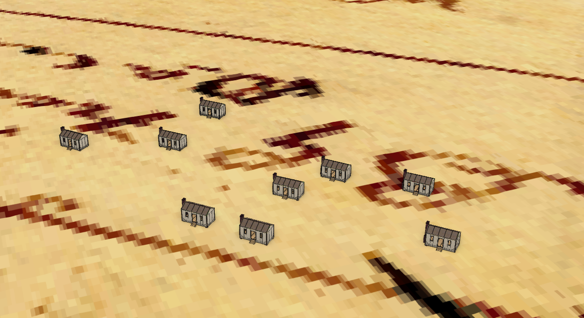

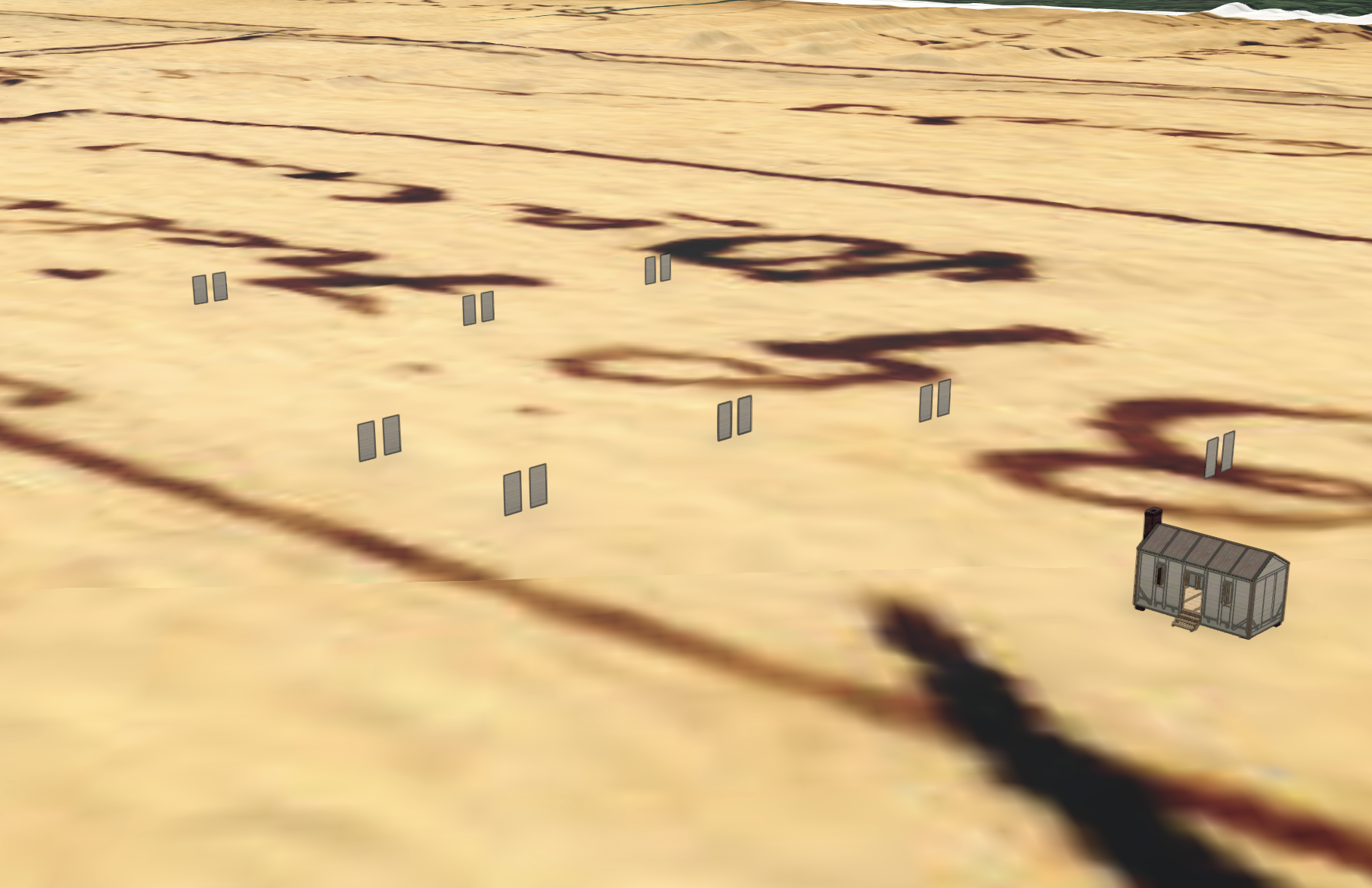

Hi all, I'm having trouble displaying BIM data in ArcOnline. I added the .RVT files into my 3d scene in ArcPro, where they all display fine. When I exported the web scene to ArcOnline however, I can only view one whole building at once in the Building Explorer. I need to be able to see all of the buildings at once, as well as have them all show up when I add the web scene to a StoryMap, since viewers of the StoryMap don't have the option to use the Building Explorer. I've tried running the Create Building Scene Layer tool in ArcPro, but when I upload the package to ArcOnline and add it to my web scene, I'm still running into the same issue. Does anyone have any ideas on how I can get all of the buildings to display at once? I've attached a screenshot of how it looks in ArcPro (ideally how I'd like it to look in ArcOnline) and a screenshot of my current issue in ArcOnline.Site1_1.PNGScreenshot 2023-07-31 at 11.08.18 AM.png

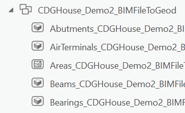

From that link, if I want to have more than one BIM file into a single .slpk,
I would like to ask which step you merge all the BIM files together?
Because, in the first step, we use BIM File to Geodatabase and the output is one dataset of one BIM file.
How could we merge dataset with dataset? or do we have to match and merge each single layer manually like merge Abutment of building1 with Abutment of building2 and then merge AirTerminal of building1 with AirTerminal of building2?
That would be really painful then.
And for the next step, the tool is Make Building Layer and I don't think we can merge in this step.

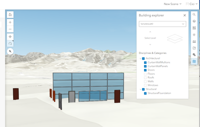

Hi Hannah, I suggest giving the building explorer widget (see below) in Scene Viewer on ArcGIS Online a try. You can access it by clicking the 'building' icon or directly selecting the building scene layer.
 If you want to view all buildings by level or discipline simultaneously, you can import all the Revit models when running Make Building Layer. However, if you only want to interact with one specific Building Scene Layer, then you should run Make Building Layer separately for each Revit model.
