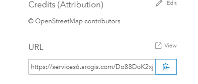

Check out the details of the service. It's possible to add a feature service from another organization using a service URL. Could your former coworker have done that?
Just to give you an example, I've added a layer from outside of my organization, but wanted it accessible as a searchable Item in the portal for users making maps, etc. Looking at the URL in the lower-right of the item's Overview page, I can see that it's coming from a different org:

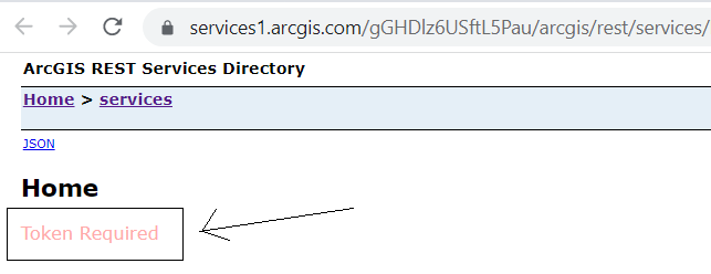

BethanyCrenshaw1
Hi Josh,
Thank you for the suggestion.  The URL takes me to this page that says "Token Required."  So maybe it could be pulling from somewhere else.
