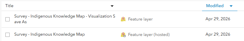

I have a hosted feature layer in AGOL:
I can open the layer in the Visualizations tab, change something like the symbology, the pop-up field order, or the form configuration field order. Then Save As.
The new layer is shown in the Contents tab as a feature layer, not as a hosted feature layer.
Questions:
  1. What's the difference between a hosted feature layer and a feature layer?
  2. Does the feature layer point to the hosted feature layer?
  3. Does a feature layer not allow me to set privileges for it?
  4. Why would I use a feature layer instead of a view?
RussRoberts
Esri Notable Contributor
Save As is creating a new feature layer item that is using the original hosted service. Its not the original hosted feature layer item so that's why it does not say hosted but if you looked at the layer JSON you will see it just points to the same service as the hosted one but you cannot alter editing functionality, overall sharing level of the original service and more. It is also not a view where a backing view layer has the restricted area of interest, fields and editing configuration.
