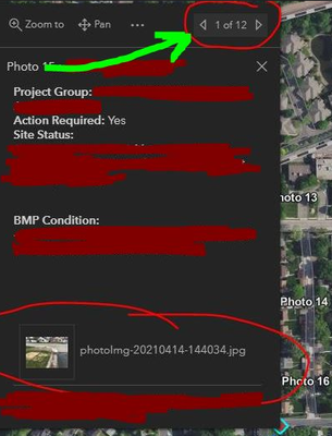

One of our users has a Dashboard with a Data Selector that can filter crime locations by date. When she uses the data selector only crimes that occurred during the date range show up in the map. However, if she clicks on one of the filtered points she sees the popup for all crimes at that location not just the date specific crimes. This is not a problem is Dashboard Classic, but is in the newer version of Dashboard. Is this a known issue?

Following....we have the same issue. When we click on a filtered point, we get the popup for all feature at that location. Like Bradly, this was not an issue before the updates this week.

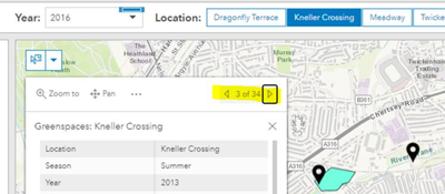

We have the same issue in newly created dashboards which did not exist prior to the recent release.
The filter is applied to the layer but not to the associated popup.

I am still having the same issue as well - using the Date to filter results in the map, upon using the select tool on the map, all the instances are selected and not filtered out.
My example - use the Date Selector to filter results in the map. Then upon using the select tool, the widgets should show an updated count of instances, not the unfiltered original amount.
