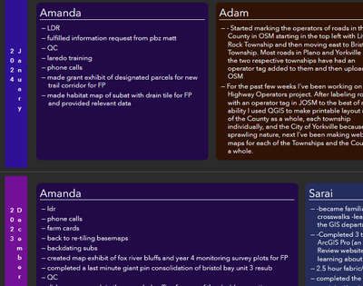

One of my favorites: we have a form that we use as a weekly work report, and a data expression can collect all entries for a given month, group them by submitting user, and display the resulting entries in a nice, compact, per-month list that adjusts for the number of unique users reporting work that month.
