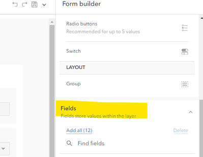

I wanted to add on to the response to Question 3 regarding adding existing fields to forms. Yes, this is possible. When adding fields to a form, you have the option to:
A) Create new fields as you've been doing, by selecting an input type from the options on the right.
B) You can also drag and drop existing fields onto the form (ie Codes). On the right, scroll down toward the bottom to see the Fields you can choose from. You should see the Codes field listed there. Then you can format that field however you like (drop down, radio button, etc).
