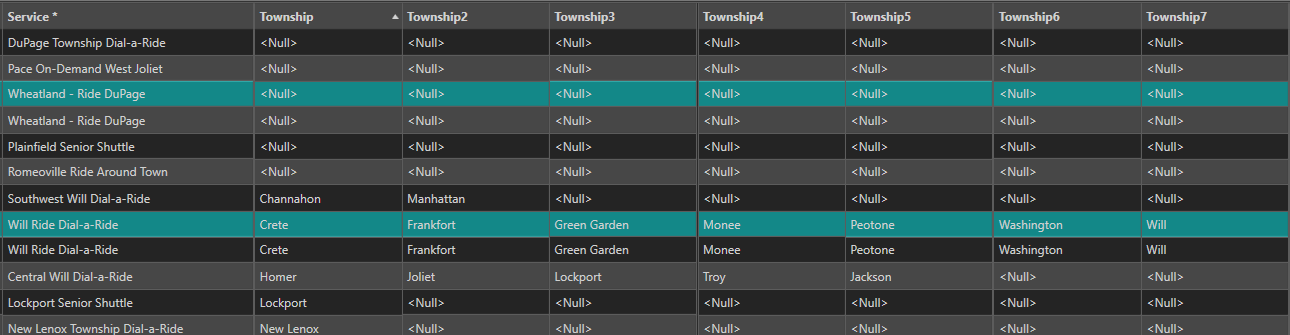

In the new Map Viewer, I have one simple hosted feature layer with 15 features. The fields I'm concerned with could have none or up to seven values, respectively. I'm attempting to build an Arcade expression that displays the value when there is one (or many). And when there is no value, display nothing.
For example, the first highlighted row (Wheatland) has no values, whereas the second highlighted row (Will Ride) has seven.
The following works to get me the first value to display in the popup when there is one. I don't know how to properly display many.

In the map, if I were to click the Wheatland polygon, I would see nothing. And if I clicked the Will Ride poly I would see: Township: Crete, Frankfort, Green Garden, Monee, Peotone, Washington, Will

This code will return the list of townships, leaving out the blank ones.
Expects($feature, 'Townshi*'); //Requests all fields beginning with "Townshi"
var fieldArr = ['Township','Township2','Township3','Township4','Township5','Township6','Township7'];
var output = [];
for (var index in fieldArr) {
  if (!IsEmpty($feature[fieldArr[index]])) Push(output, $feature[fieldArr[index]])
return Concatenate(output, ", ")

JaredPilbeam2
MVP Alum
That's it! Thanks a lot. I see I do not need to include the HTML as the expression works like I expect on its own. The only thing is how to somehow work the string "Township: "  into the expression.
