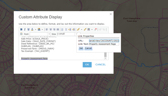

I have a web app we've been using for years now and every year we have to go in to the URL properties of the custom attribute display and change the URL of a link to reflect the new year.
Ideally we can use the current year but I have no idea how to incorporate that as any code I try to put in the LINK properties shows up as text in the URL rather than returning the year.
Is there a way to access the current year in the URL field of a link in a custom attribute display?
In the URL below I hacked and tried adding javascript like Date.getFullYear() but it adds that to the URL string rather than running code to return current year.
Help is greatly appreciated.

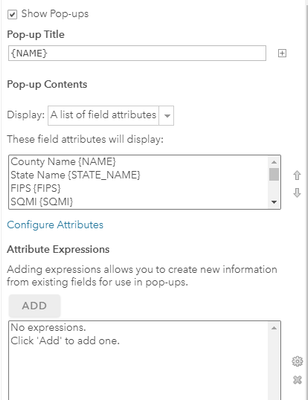

Try creating a custom popup expression:
Year(Now())
And then piping that expression into your popup.

jcarlson
MVP Alum
Click "Add" under "Attribute Expressions" on the "configure popup" panel.

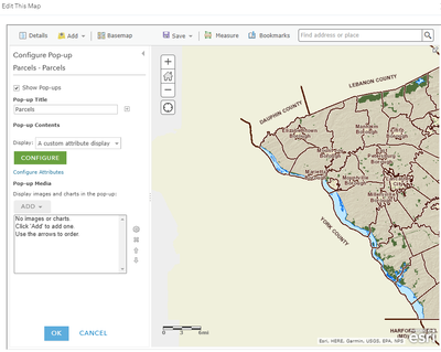

by Anonymous User
Not applicable
Thanks. This app is currently on a server with an older version of portal and unfortunately the popup dialog doesn't show attribute expressions. That would be the way to do it though. Thank you!
